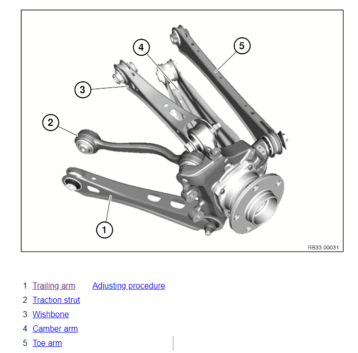

Witam. Czy jest ktoś w stanie podesłać mi z jaką siłą dokręcić tylne zawieszenie ??
  Type Thread Tightening specifications Torque
1AZ Trailing arm to rear axle support
F25 / F26 M12
Tighten down in normal position.
Renew screw and nut.
      Jointing torque 100 Nm
      Angle of rotation 90 °
2AZ Trailing arm to wheel carrier
F25 / F26 M12
3AZ Control arm to rear axle support
F25 / F26 M12
4AZ Control arm to wheel carrier
F25 / F26 M14
Renew screw.
      Jointing torque 165 Nm
5AZ Wishbone to rear axle support
F25 / F26 M14 Renew screw and nut.
6AZ Wishbone to wheel carrier
F25 / F26 M12
7AZ Toe arm to rear axle support
F25 / F26 M14
Renew nut.
165 Nm
8AZ Toe arm to wheel carrier
F25 / F26 M14
Renew screw.
9AZ Camber control arm to wheel carrier
10AZ Camber control arm to rear axle support
F25 / F26 M14
Replace eccentric bolt and nut.
      Jointing torque 80 Nm
